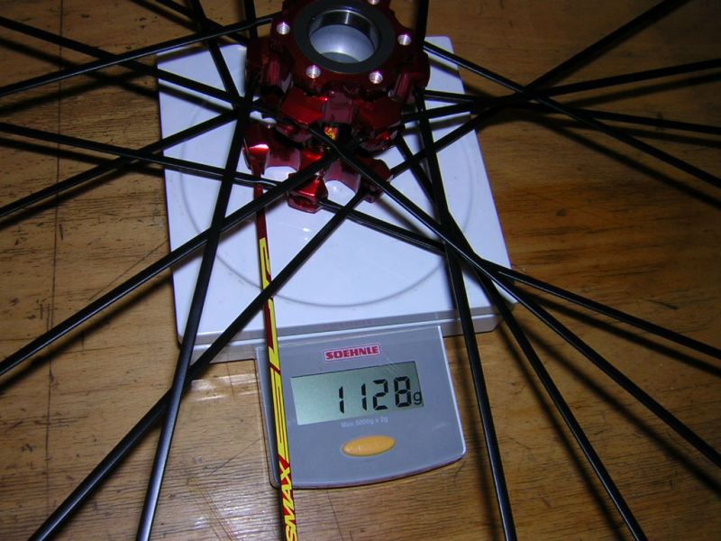

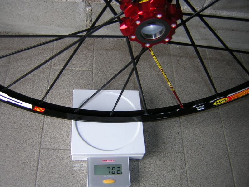

my front wheel

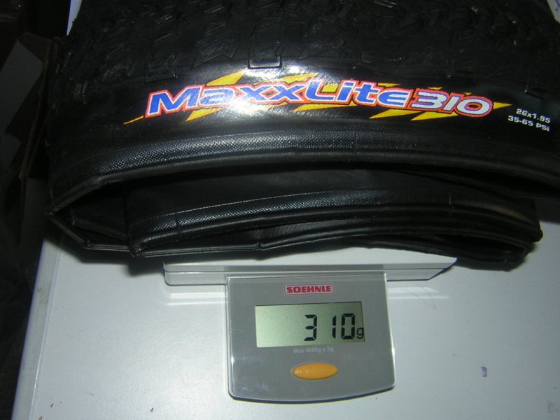

Messagede eliflap » Ven 22 Fév 2008 23:47
my tyre 26 x1,95 maxxislite

1128 - 701 - 310 = latex 117 gr

Messagede proracing » Ven 22 Fév 2008 23:50
schwalbe furious Fred is under 300 gr.
the Schwalbe is bigger than the Maxxis
